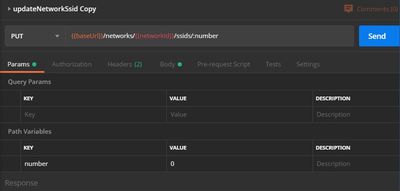

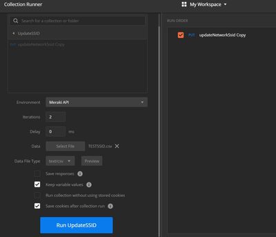

Hello, yes some extra detail would be great.  I'm trying to use the PUT below to simply change the first SSID name across 2 different networks in a .csv.  Am I correct that the csv should only include the 2 variables in the 1st image (networkId, number) and the body of the saved request called in the runner should have the static settings I want (ssid name)?
My .csv:
networkIdnumber
L_XXXXXXXXXXXXXXX0
L_YYYYYYYYYYYYYYY0

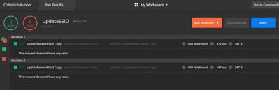

This is what I get when I try to run the collection:
Thanks!
Highlighted
Re: Update multiple devices in different networks
hi,
You csv if you open in notepad should read like this;
networkid,number
Nxxxxxxxx,0
Nxxxxxxxx,0
If you are sure that the SSID is always ID 0 then you could just hard-code this in the command, so you would only need to have the list of network ids in your csv.
the reason it's failing is because the put statement requires the variables, whereas you have them in the path variables section. it should read:
https://api.meraki.com/api/v0/networks/{{networkId}}/ssids/{{number}}
if you delete where it says :networkid and type {{networkid}} you'll see the path variable disappear from the params section. then either repeat for the :number or set this value to 0 if your ssid is always 0.
hope this helps.

That makes sense, but somehow still cant get it to work.  I have statically set 0 as the ssid number, so I only have the networkId to deal with in the csv.  When I run the collection, I get a 404 error (I am selecting the same Env that I use for individual requests)
I would delete the path variable ’number’ completely, and either have this
with your csv having the ssid number, or use this
https://api.meraki.com/api/v0/networks/{{networkId}}/ssids/0
404 is page not found so it’s the syntax of the command not enumerating to a valid page.
Highlighted
Strange, still getting the 404 error, I've gone with https://api.meraki.com/api/v0/networks/{{networkId}}/ssids/0 , but no luck (I tried the other method with {{number}} as well).
It looks like the csv data is not getting passed through to the variable.
Thanks
Highlighted
Success! Not sure why exactly, but my computer crashed and when I reopened excel and imported/resaved the csv, my collection ran successfully.  Thank you very much @5ghz!
