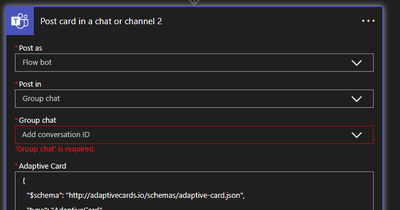

I tried this today and could not get it  to work ☹️
Here is the error I am getting on the Microsoft Flow Side
Action 'Send_each_adaptive_card' failed: The execution of template action 'Send_each_adaptive_card' failed: the result of the evaluation of 'foreach' expression '@triggerOutputs()?['body']?['attachments']' is of type 'Null'. The result must be a valid array.
The Flow template that I used
Also tried

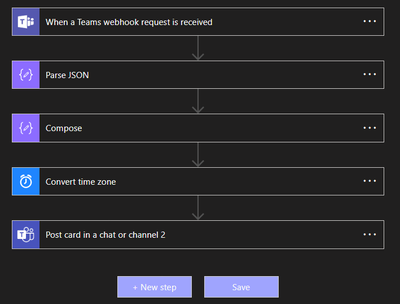

For anyone wanting to get Adaptive Cards working with the new Teams workflow with local time conversion, the following config works:
Step 1) Create the Meraki webhook receivers config as per the Meraki documentation. You will need to generate the public HTTPS webhook URL first from Step 3.
Step 2) Create a custom webhook template, and use the following config in the Liquid Body field. Edit or remove the URL field if you want a picture in the webhook card.
  "type": "message",
  "attachments": [
      "contentType": "application/vnd.microsoft.card.adaptive",
      "contentUrl": null,
      "content": {
        "$schema": "http://adaptivecards.io/schemas/adaptive-card.json",
        "type": "AdaptiveCard",
        "version": "1.2",
        "body": [
            "type": "Image",
            "url": "ADD  HTTPS URL FOR A PICTURE",
            "altText": "Logo"
            "type": "TextBlock",
            "text": "**{{networkName}}**",
            "wrap": true,
            "size": "large"
            "text": "**Message**: {{alertType}}  \n**Device**: {{deviceName}}  \n**Alert Level**: {{alertLevel}}  \n**Alert Data**: {{alertData | markdown_with_additional_formatting_for_teams}}",
            "wrap": true,
            "size": "medium"
          {% if alertData.imageUrl %}
            "type": "Image",
            "url": "{{alertData.imageUrl}}",
            "altText": "Alert Image"
          {% endif %}
            "text": "**Alert Triggered**: {{occurredAt | date: '%Y-%m-%dT%H:%M:%S'}}",
            "wrap": true,
            "size": "medium"
            "type": "ActionSet",
            "actions": [
                "type": "Action.OpenUrl",
                "title": "View Network",
                "url": "{{networkUrl}}"
                "title": "View Device",
                "url": "{{deviceUrl}}"

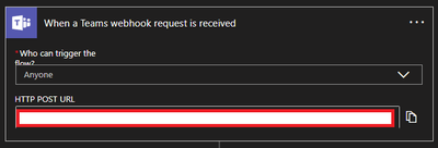

Step 3) Open Teams, right click on the chat group and select Workflows. Create a new workflow based using the "Post to a Teams chat using an incoming webhook". Complete the wizard as per your requirements.

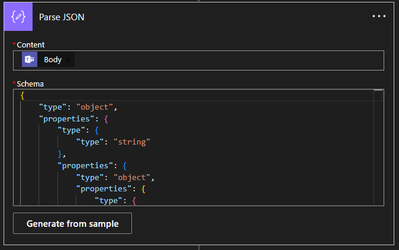

Step 4) Edit the workflow and build out the following action flow:
Schema config:
    "type": "object",
    "properties": {
        "type": {
            "type": "string"
        "properties": {
            "type": "object",
            "properties": {
                "type": {
                    "type": "object",
                    "properties": {
                        "type": {
                            "type": "string"
                "attachments": {
                    "type": "object",
                    "properties": {
                        "type": {
                            "type": "string"
                        "items": {
                            "type": "object",
                            "properties": {
                                "type": {
                                    "type": "string"
                                "properties": {
                                    "type": "object",
                                    "properties": {
                                        "contentType": {
                                            "type": "object",
                                            "properties": {
                                                "type": {
                                                    "type": "string"
                                        "content": {
                                            "type": "object",
                                            "properties": {
                                                "type": {
                                                    "type": "string"
                                                "properties": {
                                                    "type": "object",
                                                    "properties": {
                                                        "$schema": {
                                                            "type": "object",
                                                            "properties": {
                                                                "type": {
                                                                    "type": "string"
                                                        "type": {
                                                            "type": "object",
                                                            "properties": {
                                                                "type": {
                                                                    "type": "string"
                                                        "version": {
                                                            "type": "object",
                                                            "properties": {
                                                                "type": {
                                                                    "type": "string"
                                                        "body": {
                                                            "type": "object",
                                                            "properties": {
                                                                "type": {
                                                                    "type": "string"
                                                                "items": {
                                                                    "type": "object",
                                                                    "properties": {
                                                                        "type": {
                                                                            "type": "string"
                                                                        "properties": {
                                                                            "type": "object",
                                                                            "properties": {
                                                                                "type": {
                                                                                    "type": "object",
                                                                                    "properties": {
                                                                                        "type": {
                                                                                            "type": "string"
                                                                        "required": {
                                                                            "type": "array",
                                                                            "items": {
                                                                                "type": "string"
                                "required": {
                                    "type": "array",
                                    "items": {
                                        "type": "string"
Add custom Inputs expression:

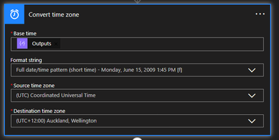

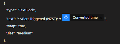

Here's the custom time line that needs to be added, using the output of the Converted Time action (add using dynamic content):

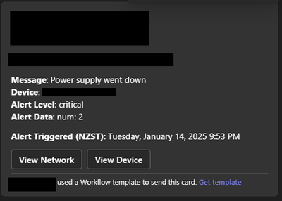

Step 5) Run a test webhook from the Meraki dashboard, you should see a successful workflow with a message card posted into the Teams chat.

Update:
The Action 2 Parse JSON Schema should be:
    "type": "object",
    "properties": {
        "type": {
            "type": "string"
        "attachments": {
            "type": "array",
            "items": {
                "type": "object",
                "properties": {
                    "contentType": {
                        "type": "string"
                    "contentUrl": {
                        "type": [
                            "string",
                            "null"
                    "content": {
                        "type": "object",
                        "properties": {
                            "$schema": {
                                "type": "string"
                            "type": {
                                "type": "string"
                            "version": {
                                "type": "string"
                            "body": {
                                "type": "array",
                                "items": {
                                    "type": "object",
                                    "properties": {
                                        "type": {
                                            "type": "string"
                                        "text": {
                                            "type": "string"
                                        "url": {
                                            "type": [
                                                "string",
                                                "null"
                                        "altText": {
                                            "type": "string"
                                        "actions": {
                                            "type": "array",
                                            "items": {
                                                "type": "object",
                                                "properties": {
                                                    "type": {
                                                        "type": "string"
                                                    "title": {
                                                        "type": "string"
                                                    "url": {
                                                        "type": "string"
and the final Adaptive card config was wrong, here is the correct one generic one that can be used instead, make sure to edit and insert your own image URL. I couldn't get the dynamic links to work so just hard code the URL to your network dashboard instead.
