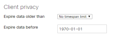

Also, you may want to check out the Network-Wide > General page to make sure that you don't have a limit set there either (you may not have that setting if you're not in Europe):

Checked for the privacy setting and I don't have it. Since I am in the US, it does not sound like I should.
