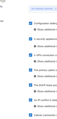

And I've tried enabling literally every checkbox in the alarm page
But I can't seem to get a response.  Any ideas of what I could be missing?
