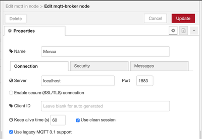

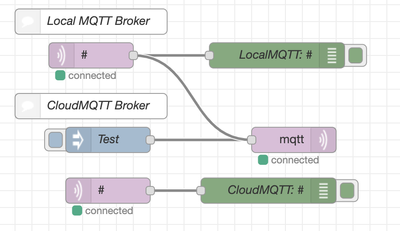

I typically use a local MQTT broker to handle the high volume of local traffic. I then could forward all or a subset of that to an upstream broker. With this method, you could have different security types for each connection and just bridge the links. I do this on a basic Raspberry Pi with Node-RED running. I used the Mosca broker node, but mosquitto would do.
