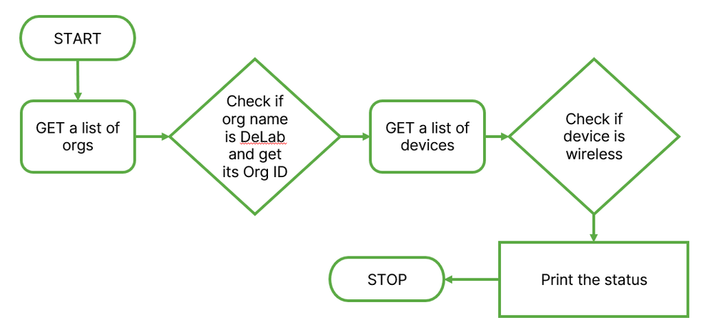

We have created the following flowchart to break down the different tasks involved for your reference.

Based on the flow chart above, the first task is to get a list of all organizations and then get org ID for the DeLab organization. We can do that by making an API call to get all orgs and store it in the list_of_orgs variable which will be passed as an input to a function called get_orgID(). We can then extract the org ID of DeLab org by simply running a for loop and if statement within. Remember, a function needs to be called in order for it to be executed so the last line of the code above does just that. Now the org_id variable will hold the org ID of the DeLab organization.

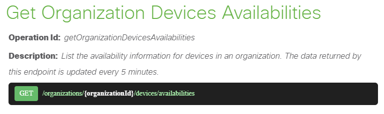

You will need to use this API endpoint to get all the information about the devices in a given org along with their status and other information. Check out the Request Parameters section for this endpoint to know what sort of information you will get as a response. We are using a variable called list_of_devices to hold that response and return it back to the caller which is what the final line is for. So ultimately the org_devices variable has the list of all devices in the DeLab organization.

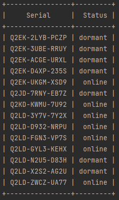

The output should be as follows:
