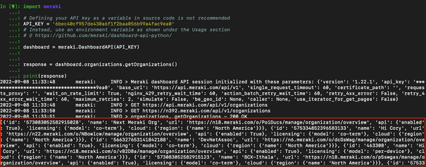

In the last part we saw how to use the Meraki library in Python to do a GET request in order to retrieve a list of organizations and how to securely use your API key, but we ended up with a response that is hard to read and process by just looking at it. We would need a way to be able to process the response, to do things like filter the list to look at specific organizations or maybe even get only certain fields from the list like the organization name and ID. In this post we will look at how to use python to process the response.
If you haven’t gone through Part 1 and Part 2 yet, please do so before proceeding.
So, at this point, we have the following output after issuing the GET list of organizations.
The text within the red box is the list of organizations. How can we process/filter this?

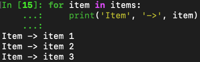

One way to parse through this list is to use a “for” loop as follows:

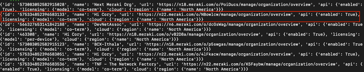

Here is the output:
Each item in response is now printed one line at a time. Great!
We can see each organization has some parameters such as id, name, url etc. We probably don’t want all of that, maybe just the name and id. How do we extract those?

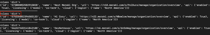

For that let us check what data type Python sees in each item stored in the variable org.
Here we use the same for loop to iterate through each item in response, but we now ask to print the type of data in the variable org using the type method, then we print the data stored in org as well, I have also added a print to add a line after each item so the output is easier to read.
Here is the output:
Here we can see that each item is seen as type class dict. What is that?

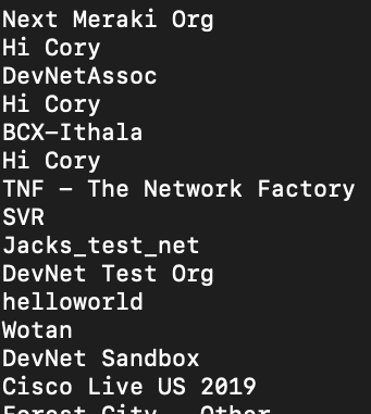

Simple! What we did here was called on the key called name here and used the print statement to print the value stored in ‘name’. Let us try this now with our list of organizations stored in response.
Here is the output:

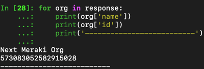

Ha! Now we just printed out the name of the org’s! What if we needed the organization ID as well? Simply, we just add that to our print statement.
Cool, now we got the organization name and its ID!
So, in this way we just use the key name in our print statement to print the values stored in the key.

Aha! Now we have the organization name and its location! What happened here? Let’s look closely at a section in the print statement, org[‘cloud’][‘region’][‘name’]. If we look back at the time when we printed each organization as is, this is what we saw.
The cloud location is stored in ‘cloud’ and within that in ‘region’ and then within ‘region’, ‘name’. Or in other words it's nested as cloud -> region -> name. So to get to the value nested, we follow the hierarchy, print org[‘cloud’][‘region’][‘name’], simple!
