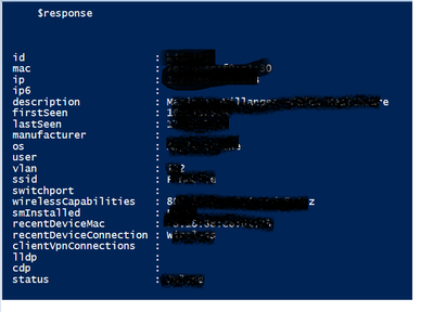

I used this script also to get the switch port detail
$apiKey = "{APIKEY}"
$url = "https://n121.meraki.com/api/v1/networks/{networkID}/clients/{clientID}"
$headers = @{
"X-Cisco-Meraki-API-Key" = $apikey
$response = Invoke-RestMethod -Uri $url -Headers $headers -Method Get
$response
But I didn't get the any port details
OUTPUT:
Please help me in this
$headers = @{
$response
OUTPUT:

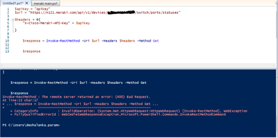

Depending on exactly what you need, you're probably looking for an endpoint like this one:
https://developer.cisco.com/meraki/api-v1/get-device-switch-ports-statuses/
Paramehswari
Comes here often
I have tried but getting the bad request below is the screen shot:
