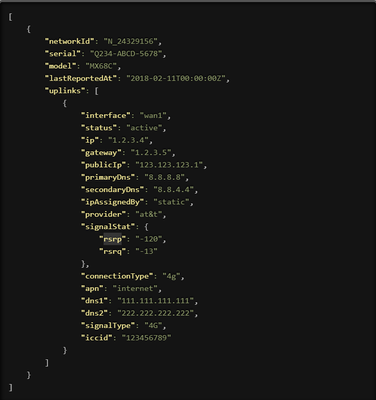

Have you checked the developer hub website?
https://developer.cisco.com/meraki/api-latest/#!get-organization-uplinks-statuses

Thank you for you reply.
Yes, I saw the info in the link you posted, but this only gives you general information of the appliance (configuration) for the specified period
and I was looking the specific parameters shown below in an specific period of time (Loss Rate%, Latency...).
What I´m looking is, since it´s used as an API of the webpage (meraki dashboard -> Uplink_details), if it was also created in the general API, but that does not seem to be the case. As I comment, I´m already getting that info, but not in the best way possible.

Hello Aponte,
If you only need loss % and latency then the uplink loss and latency endpoint will provide that.
