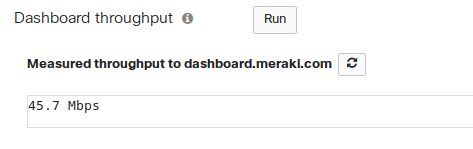

I'm doing a test with PHP together with the Meraki API.
I would be needing extra information about the possibility of performing a speed test (throughput) for each organization within the panel.
In the documentation I don't see anything related to this test.
Can you tell me how to proceed?

There is no such API to do this test.
Also this is a test to the Meraki cloud. You can't put a lot of faith in this measuring the actual maximum thoughput of your ISP circuit. It is just a general guide.

In any case I will look for some macro for the web browser to do it in about 2000 Organizations

So far there is no possibility to do it by API .

For the moment the only solution was to create a script in python and selenium to enter each Network and perform the test.

Here is a solution using Python under APIv1. Create the test and after 10 seconds retrieve the results. Assuming you pulled the active MX's serial or manually added it above this portion.
response = dashboard.devices.createDeviceLiveToolsThroughputTest(serial_number)
throughput_test_id = response['throughputTestId']
time.sleep(12)
response = dashboard.devices.getDeviceLiveToolsThroughputTest(serial_number, throughput_test_id)
print(f"Download throughput {response['result']['speeds']['downstream']}/Mbps")
