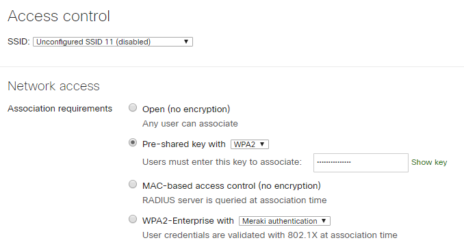

BrechtSchamp
That's because the SSID is probably set to open.
Try adding these to the code:
$data = @{
    "psk" = 'NewNewPassword' + $date
	"authMode" = 'psk'
	"encryptionMode" = 'wpa'
	"wpaEncryptionMode" = 'WPA2 only' # you could also use 'WPA1 and WPA2'
Or set it up via dashboard before running your script the first time:

Thank you very much for your response.
It worked like a charm.
The PSK is now updating properly.
