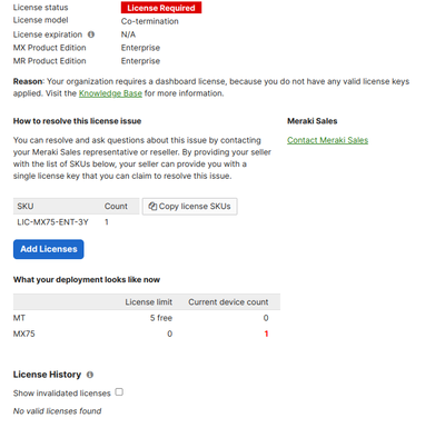

I've noticed that when creating a new organization in Cisco Meraki, the default licensing model is cotermination.

Just to clarify, the organization has no active licenses, and I created it from scratch. I'm trying to figure out how to claim the subscription license using Ansible before adding it manually. In a previous case, when I added the license manually, the org's status changed to "Subscription & License Info" (subscription license model) as expected.
