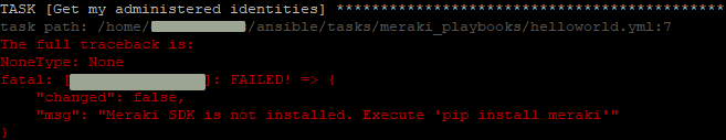

However when attempting to perform the basic who_am_i.yml script, it will fail and indicate that the SDK is not installed.

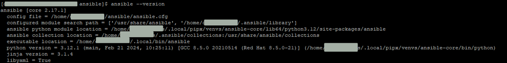

My Anisble Version. indicating that the core is 2.17.1 and the python version is 3.12

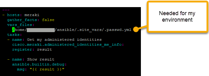

My helloworld.yml file, the vars_file is extra but in my environement it is required or else the playbook will fail.
The output of the playbook for the task.

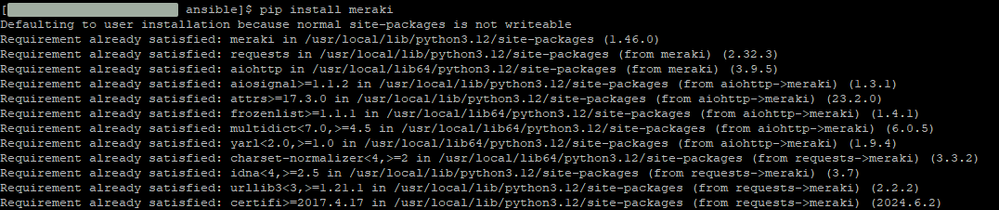

The output of pip install meraki indicating it is installed.

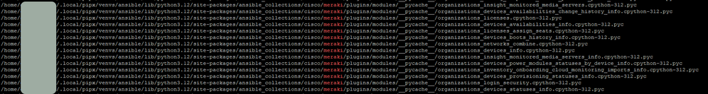

While I am uncertain, I think this would be a fraction of the SDK library for meraki but its located in ansible, which is odd.PythonLibrary.png

In that case my guess is that ansible is running in a separate Python environment - not the same one as the Meraki module is being installed into.

Python 3.12 is installed on the system, when performing the above commands you mentioned they indicate that "Requirement already satisfied", and the output is exactly the same in regards to pip vs pip3 command. Python has already been re-installed once or twice.

That is correct. I thought it wasnt. but when checking where its running, it is its own virtual environment, I even attempted to have it look outside of that environment but without any luck. so i just copied the entire library over to the virtual environment.
