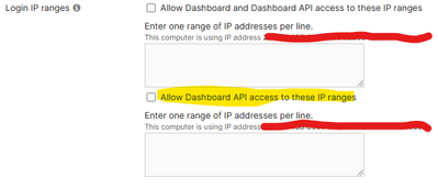

Not a good fix, but potentially if desperate enough you could consider restricting API access to a set of IP addresses until the core issue is resolved.
