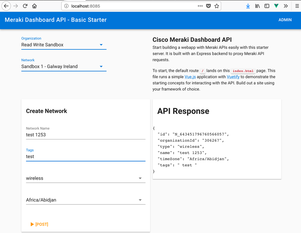

The sample code was updated to demonstrate a post by creating a new network.
Client-Side (create a network by posting data)
