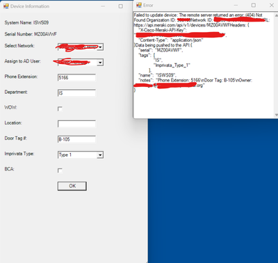

I am trying to figure out how to get my powershell script to work but keep getting a 404 error. The PS script shows a form to fill out information I have the data saved in a txt file on the workstation and I want to update the data for the computer in meraki. What is wrong and how could I fix this. Is what I am trying to do possible? I want to update the notes and or tags on a computer.
Error
Failed to update device: The remote server returned an error: (404) Not Found.
Organization ID: Redacted
Network ID: Redacted
URL: https://api.meraki.com/api/v1/devices/MZ00AVWF
Headers: {
    "X-Cisco-Meraki-API-Key":  "Redacted",
    "Content-Type":  "application/json"
Data being pushed to the API:
    "serial":  "MZ00AVWF",
    "tags":  [
                 "IS",
                 "Imprivata_Type_1"
    "name":  "ISWS09",
    "notes":  "Phone Extension: 5166\nDoor Tag: B-105\nOwner: Redacted@Redacted.org"
PowerShell Script

        $notes += "Location: $($locationTextBox.Text)`n"
    if ($doorTagTextBox.Text) {
        $notes += "Door Tag: $($doorTagTextBox.Text)`n"
    if ($adUserEmail) {
        $notes += "Owner: $adUserEmail"
    # Get the serial number of the computer
    $serialNumber = Get-ComputerSerialNumber
    # Call the Meraki API to update the device notes and tags
    $url = "https://api.meraki.com/api/v1/devices/$serialNumber"
    $headers = @{
        "X-Cisco-Meraki-API-Key" = $apiKey
        "Content-Type" = "application/json"
    $body = @{
        name = $systemName
        notes = $notes
        tags = $tags
        serial = $serialNumber
    } | ConvertTo-Json
    try {
        $response = Invoke-RestMethod -Method Put -Uri $url -Headers $headers -Body $body
        [System.Windows.Forms.MessageBox]::Show("Device updated successfully.")
    } catch {
        $errorMessage = "Failed to update device: $_`n`nOrganization ID: $orgId`nNetwork ID: $($selectedNetwork.id)`nURL: $url`nHeaders: $($headers | ConvertTo-Json)`n`nData being pushed to the API:`n$body"

1 Reply 1
sungod
This will not work, the endpoint is for Meraki devices, not arbitrary client devices such as PCs etc.
There is no Meraki device with that serial number, so you get a 404 response.
If the PC/whatever is managed by System Manager, there're a bunch of endpoints to get/set various info, for instance https://developer.cisco.com/meraki/api-v1/modify-network-sm-devices-tags/
I don't recall seeing an endpoint that updates notes/tags info for non-managed clients, if there were one I'd expect it to be based on the Dashboard generated client ID or client MAC, not the client's native serial number.
