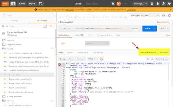

Hi,
try to use postman for this GET via Dashboard API but doesn't works, some ideas?
GET Return a client
https://api.meraki.com/api/v0/networks/{{networkId}}/clients/{{clientMac}}
Return the client associated with the given identifier. This endpoint will lookup by client ID or either the MAC or IP depending on whether the network uses Track-by-IP.
All the GET without "clientMac" variable works perfectly.

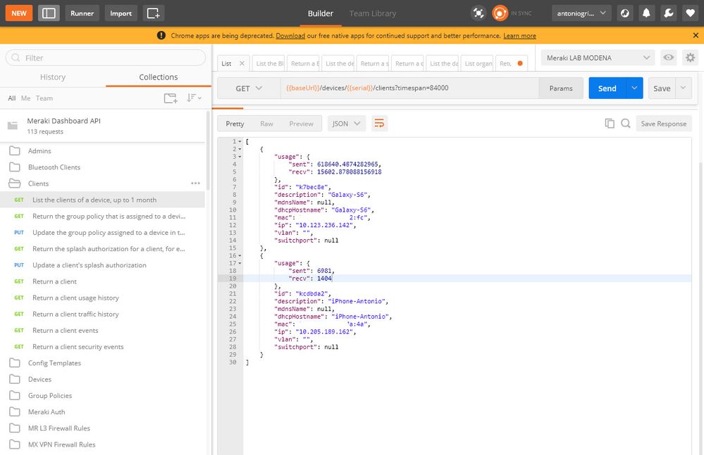

I take that back.  I can't get this new API to work either.
I've had success in the past with the similar API
/api/v0/devices/[serial]/clients?timespan=7200
This returns all devices connected to a specified device.  You would call this API for each device in a network.

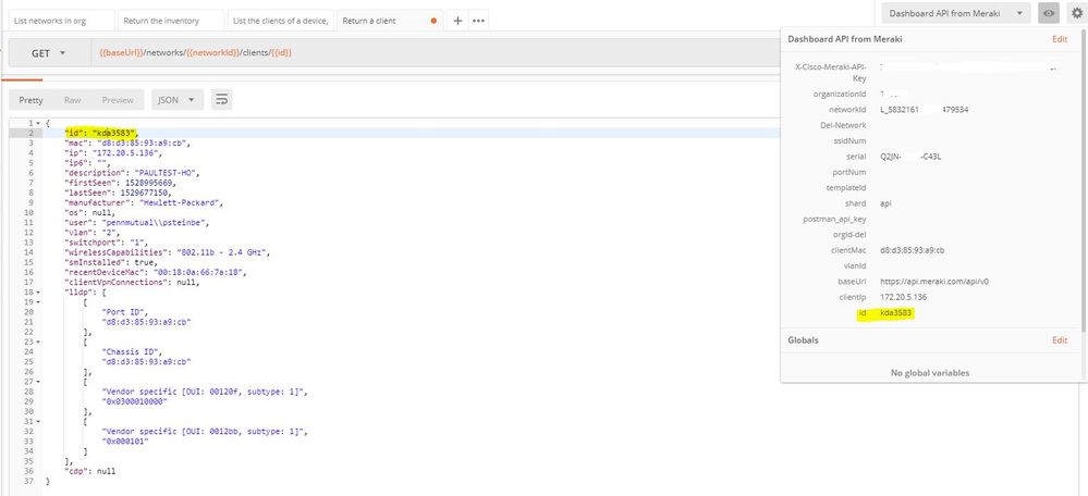

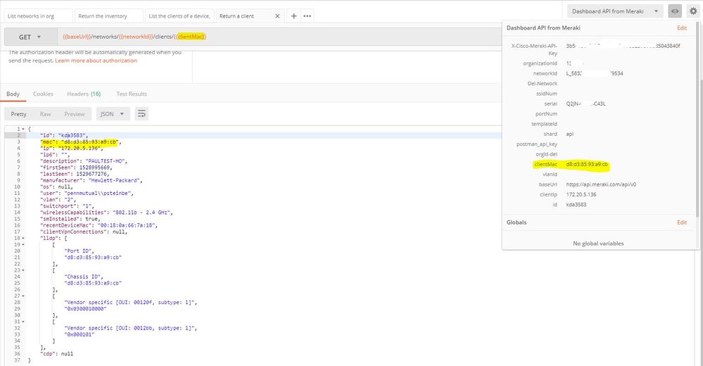

Re: API Dashboard "Return a client" GET doesn't works
I haven't had an issue with new the API call.  Can you post your results?
This is the get request from my Postman "{{baseUrl}}/networks/{{networkId}}/clients/{{clientMac}}"
I'm seeing the same issue.
I see that the PIP module is updated (0.34) and it has the Client function defined.
when I attempt to make the call, however, it fails.
it doesn't matter if I use the mac, IP or client-ID.
for anyone that can make this work, what is your dashboard address?
I'm hitting n49, and I'm wondering if there is just a slowness in the calls being opened to other shards

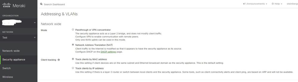

@AntonioGrillo
I don't track my clients by IP.  You need to turn that on.
see documentation:
https://documentation.meraki.com/MX-Z/Monitoring_and_Reporting/Client_Tracking_Options
FYI, I tried to test tracking by IP and got the following error:
  • Tracking clients by IP addresses is not supported in a combined network and will break client tracking data.

@AntonioGrillo
Can you show me your Security Appliance/Addressing & Vlans page?meraki_comm.JPG

@Steinbep it shouldn't matter what your tracking is set to, as long as you are calling the correct element. If you are tracking by Mac, you call the client Mac. if you are tracking by IP, you call the client IP. but you should *always* be able to call the client ID. I just tested this both with track Mac and track IP and I get a 404 error either way I try to test it.

Works both ways for me.
