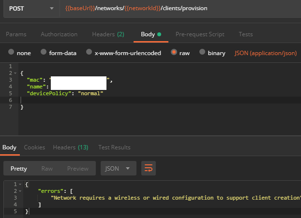

Thanks for trying !
I was thinking about using the request "Provisions a client with a name and policy", that could maybe do the job.
However, as I try to use it, I always run into this error 400:
"errors": [
"Network requires a wireless or wired configuration to support client creation"
I don't understand what is this configuration needed, do you have an idea on how to solve it?

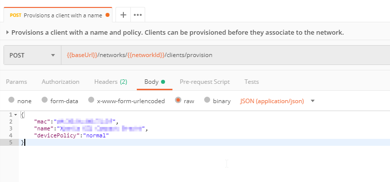

I just tested it with Postman and it works. I have an environment setup where baseUrl and networkId are already setup (Info here: https://create.meraki.io/build/meraki-postman-collection-getting-started/).
So the only thing I needed to do was double click the call in the collection so a new tab opens in postman for that call. Then below go to the "body" section and fill in the needed data ( "mac", "name", "devicePolicy"). In this case because I only wanted to change the name I set devicePolicy to "normal".
This is what that looks like:

I can run the other requests without problems, so I don't think it is a problem with my environment.
I guess it might be a problem with my network config, but I don't know what excactly.
Do you have access to the "add client" button on the "clients" page of the dashboard ?
I can see it here on the first image, but it's not showing in my dashboard: https://documentation.meraki.com/MX/Group_Policies_and_Blacklisting/Pre-configure_Network_Policy_for...
Here is what it looks like on postman when I try :
Thanks for your time and help 🙂

I solved the problem by changing my network Type to "combined", and now I can use the "Add Client" button and the API to change clients' names.
Thanks for the help.
