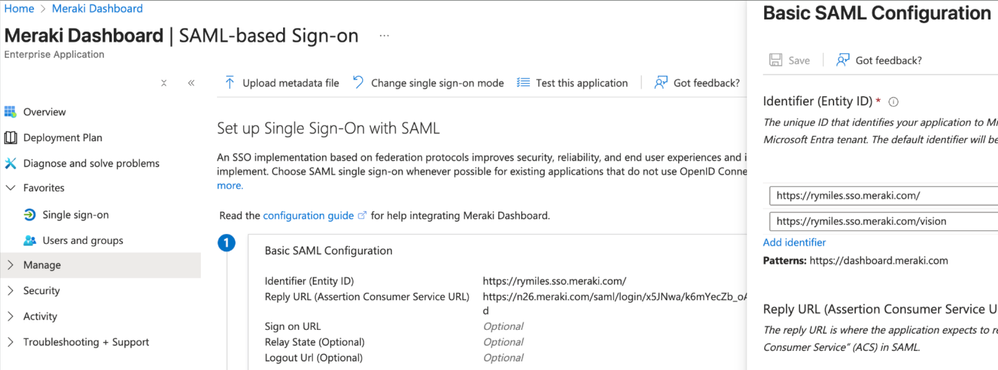

Use the subdomain option to enter a unique name for each Org
https://documentation.meraki.com/Platform_Management/Dashboard_Administration/Operate_and_Maintain/M...
On the Entra side use that unique name as the entity ID for each Ent app you create for each Meraki Org.
Example of my config
