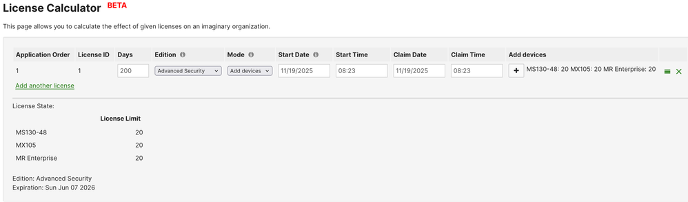

Example, sample Org with MX, MS, MR. 200 days from expiration.

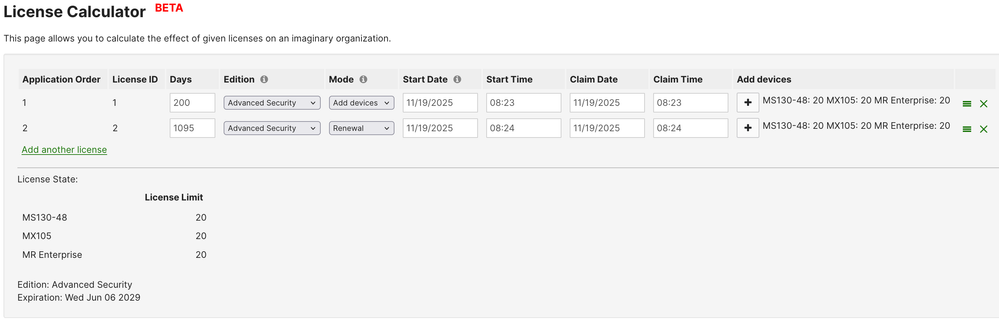

Apply a 3 YR renewal for that exact gear and it adds 3 YRs to the co-term date.
