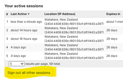

I *think* this is related to existing unused sessions (such as when someone just quites the browser).
Go to "My Profile" (in the top right-hand corner), and then down to "Active Sessions".  I'm up to 63 at the moment.  From time to time, I need to use the "Sign out all other sessions" to clear them out, and then I think it works better.
When I get logged out for inactivity, I try to use the "resume session" option.  It is in small print on the logout page.  This helps prevent another session from being created.

Tease me.  Try the option above to log out of every session, and see if it is still as bad.
cmr
I will do, I'll also report how many sessions I have...

Does this option not work?

That option does not appear on my view.

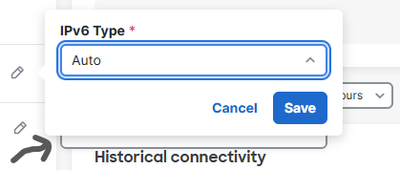

Latest dashboard issue I have found is trying to change an AP from static IP to DHCP.  The drop down opens behind the main dialogue box so you have to know what key combinations are required to change it, with it being completely hidden...  The same applies for the IPv6 mode...
