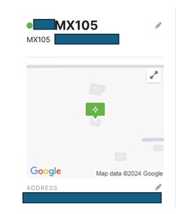

Or were you referring to the physical address that is reflected for each device.  That can be adjusted by simply going to each device and selecting the pencil where ADDRESS is at and changing it to reflect accurate physical locations.

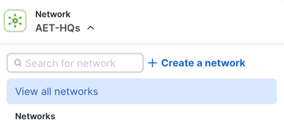

I'm not talking about Organization > Configure > Inventory.
I meant the network dropdown when you select a site to manage the devices.

Hopefully I understand you correctly.
You can select +Create a network to have 2 separate locations.
And to move the devices or split would still need to move the devices using the Organization > Configure > Inventory to the new network.
