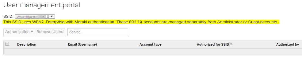

It's also documented on the Users page:

Hey, I've seen that message popping up with wired authentication policy but not with wireless SSID's.
So if I read your answers correctly Meraki manages two separate users dB's per organization being one for admins (dashboard mgmt, clientVPN) and guests (guest portal, clientVPN) and another purely for dot1x purposes wired and wireless.
