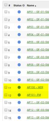

As per the image below when sorting the device by names device #100 is coming after device #10 not after device #99.
I understand this issue with site design.
Is any have any idea about this?

"Simple" fix is usually to append 0 in front of two digit numbers. Try it in Excel.
It's... relatively easy to do with a script, but if you dunno how to code, could also click through rapidly or make an intern do it.

That is correct behaviour. Specifically the space after AF10 has an ASCII code of 32, while the character in the same spot - "0" - has an ASCII code of 48.
Nothing to do with Meraki. This is simple, standard and correct sorting alphabetical behaviour.
