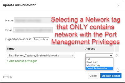

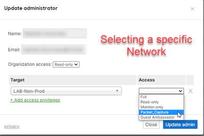

Hi ,
I'm currently testing this feature.
1- Let's say I have 300 networks with a network tag 'Packet_capture_enabled' , when going to organization > administrators , and selecting the Tag 'Packet_capture_enabled' I can't select the Port management Privileges. I can only select the privilege IF I manually add the 300 networks to the administrator Privilege.
2- Upon looking at the OpenApiSpec , I don't see any endpoints to configure Port Management Privileges ( since they are Network-Wide ). We have over 1500 networks, this might be hard to do without APIs.
Thanks ,
Both are valid points. So the Access privilege options are based on the target network selected. When using the network tag to scope network(s), there will be only four default privileges, given different networks might contain different device types.
You are right about no API support for port management privilege setting.  And unfortunately, the Update an Administrator  endpoint currently does not support the custom access privilege either (in your case Packet_Capture) . I bet there is some good reasons for this, but it may be worth reaching out to your Meraki sales team and submitting a feature request to evaluate.
