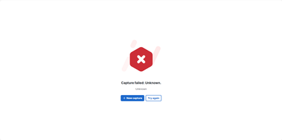

Hello,
I don't know if other people has the same issue. But when I try to make a Packet Capture for a switch port I get an error. I can fill in the information to start the capture. Then I see a screen that the capture is running but after that I get an error screen with Unknown Error.
When I then look in my Stored captures I see the capture I tried to make but it has the status Capturing, and the File Size is null bytes. The name of the Packet Capture is greyed out.
When I try to download the Packet Capture instead of saving it in the cloud I have the same result.
Do other people also experience this issue?

I tested this on a network with switches that run on version MS 17.2.1. And it also has some 9300 switches running on version CS17.2.1
Pasha
Comes here often
I have the same issues, and our switches are running 17.1.4
Pasha
Comes here often
I have the same issue! But when I set the output to "view output live" it works!

There is known issue on our side that has been raised with our Development Team. They are actively working on a fix.
Workaround: using "/manage/dashboard/tcpdump" at the end.
New version - Change this:
https://nXXX.meraki.com/XXXXXX/manage/packet_captures/new_capture
To Old version:
https://nXXX.meraki.com/XXXXXX/manage/dashboard/tcpdump
