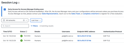

Meraki informed us that the issue was fixed on their side.
We are slowing reactivating Access Manager on our networks and the Session Logs looks good.
In the username column we see again the name.surname pattern.
No changes to our certificates, nor to Meraki settings.

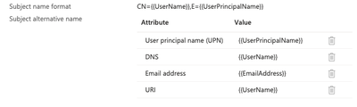

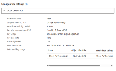

Yesterday we tested with an Intune certificate built as follows:
Then we tried all available Identity settings in Meraki (Subject common name, RFC822, DNS ), asking each time to a test client to try authenticating.
Outcomes:
  • Independently from the identity setting, the Username column in Session Logs always shows the full name.surname@domain.com pattern.
  • All attempts lead to the same: "Unexpected error".
The impression is that the Identity selection is not working anymore, or the EntraID lookup is broken.
At the moment Meraki is still investigating the issue and unable to provide any guidance.
