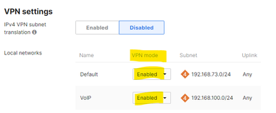

You don't say much about your Spoke MX setup...   Are the VLANs at the spoke set to VPN enabled, for example?   What do you see in the MX Route table at each end?

On the Site to Site VPN page I have Hub(Mesh) selected
Under VPN Settings I have the AWS VPC subnet listed with vpn enabled.
The route table on the MX shows Green status routes into ALL of my different subnets

Make sure the on-premise MX has the VLAN where the internal machine is located included in AutoVPN.
