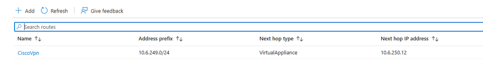

I have created a route table with a single route for my VPN clients, which is to say that 10.6.249.0/24 has a next-hop IP of 10.6.250.12. I assigned this to the subnet with my resources in, I also made sure this subnet was added in the vMX as a local network in the site-to-site VPN settings, and that it was a route that my VPN clients knew about.

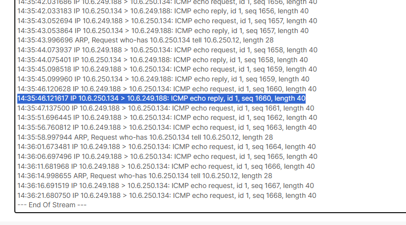

The VPN connects successfully, but I can't ping anything in 10.6.250.128/25. Running a packet capture on the vMX shows the packets leaving, but nothing coming back. Pinging an address in the VPN subnet from the resources in Azure results in nothing showing up in the packet capture. The only thing that brings everything to life is adding the route table onto the same subnet as the vMX is in - something that the docs explicitly say not to do.

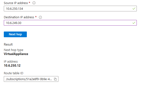

Out of curiosity, what is the next-hop type for your original route? Can you confirm if this is configured as VirtualAppliance? This can help to find the route:
https://learn.microsoft.com/en-us/azure/network-watcher/diagnose-vm-network-routing-problem#view-det...

The route is a virtual appliance route, you can see on the packet capture from the MX exactly when I drop the route table off the subnet the vMX is in.
Effective routes and next-hop diagnostics from Azure portal all look as they should, but traffic doesn't route unless the vMX subnet also has the route table.
