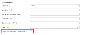

  1. Marketplace Deployment: The Cisco Meraki vMX deployment now includes an option to “Enable and configure LAN interface,” which attaches a second vNIC to the VM to act as the LAN/inside interface. This is not yet reflected in the Meraki Docs.

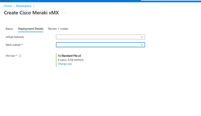

I'm trying to deploy the Meraki vMX in routed mode, but I'm running into issues installing version 19.1 from the Azure Marketplace. Could you share how you went about deploying it or if there’s a specific workaround you used?
Thanks in advance!
jimg3
@lovethecloud you deploy the vMX with the additional interface then upgrade to the 19.x firmware train after it is installed. stable release candidate is 19.1.7.2
lovethecloud
I think that's what I tried but I got an interface error:
"error": { "code": "InvalidResourceReference", "message": "Resource /subscriptions/c3417xxx/resourceGroups/TEST-Meraki-vMX/providers/Microsoft.Network/virtualNetworks/TEST_vMX_vnet/subnets/lan-subnet referenced by resource /subscriptions/c3417exxxxc/resourceGroups/mrg-cisco-meraki-vmx-20250422171814/providers/Microsoft.Network/networkInterfaces/TEST-AZ-FWLanInterface was not found. Please make sure that the referenced resource exists, and that both resources are in the same region.", "details": [] } }
lovethecloud
Ok, got it working. I had to create the LAN subnet before Meraki deployment, not during deployment. Same goes for the WAN subnet.
