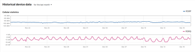

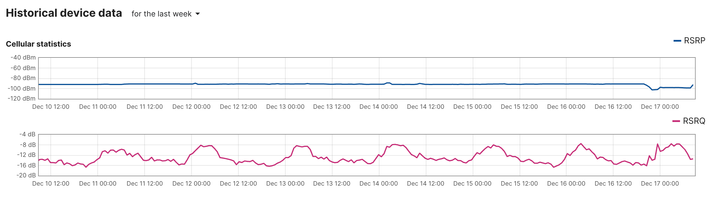

I am trying to understand the behavior of my MG RSRQ,
I can clearly see a daily cycle, where signal has a great quality at night, and a bad quality at daytime :
Month view :
Week view :
The MG is not moving, and it is positioned in my home (office room),
Do you have the same behavior with your MG ? Is this a normal behavior ?
Thanks for your help team !

The only things you can do is put the MG where you get the best signal, or try a different cell provider as there won't be an even spread of users.

@xaviervalette are you in an area with quite a few other people within 1km or so?  It is completely normal that the signal will degrade as more people use the cell tower (generally in the day time).  If not, then I would expect a more constant signal.

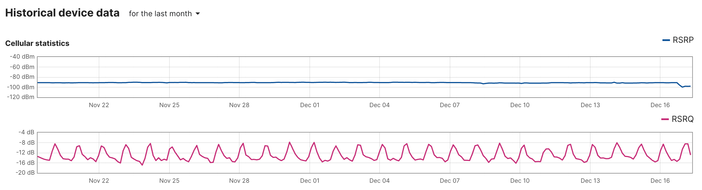

RaphaelL
Bonjour Xavier ,
I also have observed the same behavior across Canada , even in some distant part of the region :
MX68CW :
This is a network close to my home in a distant village of a population of 4-5K, but we are all on the same cell towers.
