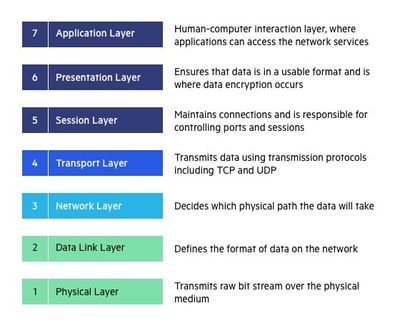

DarrenOC
@guile99 , remember your OSI model? Work from the bottom when troubleshooting.
