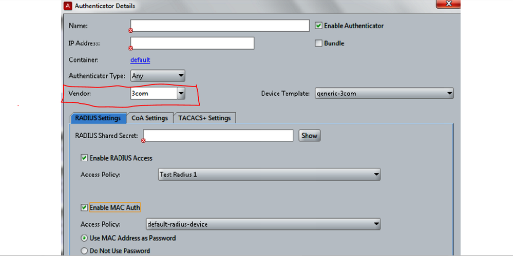

Hi there,
We are replacing 40 AVAYA Wirelss APs with Meraki MR45 APs; however, the client currently is using  Avaya Identity Engines Ignition Server IDE (RADIUS) which performs authentication and identity services. Unfortunately under authenticator details, I can't find Meraki under "Vendor" drop menu (Cisco is there)...
Is there a way to confirm that Meraki MR 45 will be authenticated via AVAYA RADIUS  ?

I believe RADIUS dictionary composite of RADIUS VSA Name & Attribute Type
Kindly check the picture below :

In order to create a custom device template in the Avaya IDE, we need Meraki  RADIUS Dictionary Files ...
Where can I obtain them?
RADIUS attribute Files:  (RADIUS VSA Name/ Attribute Type) and vendor ID for Meraki MR

I've been contacting AVAYA/Extremenetworks support and they are not sure if selecting Cisco as vendor will work for Meraki. However, they showed me how to add new vendor and new selection of attribute value pairs specific to that vendor under the Vendors listing. (Does Meraki have a Vendor ID?)
https://gtacknowledge.extremenetworks.com/articles/How_To/000037372
The client currently is using AVAYA IDE as RADIUS server and it's up and running and working fine, so he is not looking to replace it with Microsoft Network Policy Server (NPS).
We are going for live deployment in two days; and I can't risk it if the AVAYA IDE RADIUS doesn't accept Cisco vendor for Meraki.

AhmedK
Thanks so much!
It works with Cisco as vendor!
