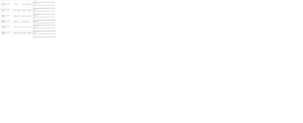

Hello All,
We are getting the below errors on our meraki access point
Client attempted to associate 3 times on the 5 GHz band.t
ype='Association attempts' num='3' associated='false' radio='1' vap='0'
Client made a request to the DNS server, but it did not respond.
type='NO DNS response' associated='false' radio='1' vap='0'
Client made a request to the DHCP server, but it did not respond.
type='NO DHCP response' associated='false' radio='1' vap='0'
We have almost done all troubleshooting but its not resolving the issue because of which clients are getting frequent internet disconnection and slow internet and wireless health report of the AP is stuck in 85 to 100%..

Which firmware are you running, who is your DHCP server, an MX or your own?
How is the DHCP availability for that pool looking?
We are running 26.7 latest one... DHCP on a dedicated server..
DHCP pool is enough
Connection to DHCP server on a wired PC is not a problem.. internet browsing works fine..
Issue is happening on wireless only..

Can you validate the switch port configuration for the AP? How do you have the SSID access-control setup? I would say in my experience, its been 'normal' to see some devices run into those issues (due to the nature of networking in general, plus wifi on top of it), but not 'constantly'. If you see constant issues then there is an underlying problem, very possibly not wi-fi related too.

Hello Nolan,
My switch port configuration is as below
switchport trunk
switch port no negotiate
power inline auto
please share with me the reference switch port configuration with your expertise

yes for local users and guests...
I'm not aware of any issues with the MR53s and the firmware version 26.7, however there is one issue that has occasionally popped-up affecting the MR45/55 with wireless clients trying to get an address from DHCP.
Just to eliminate the possibility of this problem with the 26.7, are you able to roll back to the latest stable 26.6.1 and re-test?

Sorry to dig out an old thread but I am having this exact issue out of nowhere today!
MR45s running v27.6 - have been working fine but all of a sudden I am seeing almost 100% DNS failures on some APs at site. Wired is working fine, DHCP has plenty of space, DNS server is online, etc..
Did you find a particular fix for this problem in the end?

So mine was potentially linked to a switch issue but not convinced. We had a Cisco 9500X layer 3 switch at this particular site that had some high CPU % usage at the same time of the DNS errors.We upraded the IOS on the switch and restarted all the MRs in the same change window, after that the DNS issues stopped occurring.
We had a similar issue recently at a second site, this time round we just bumped the MR firmware to v27.1.1 and it seems to have done the trick for that site.
The only common step across both of our occurrences to fix has been a reboot of all the MRs!

Fixed the issue. We reload all switches including core 1 and 2. After that everything is working properly.(We got an IP tv issue at the same time)
