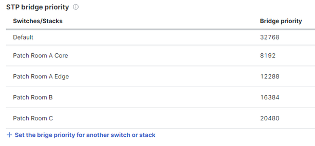

I would set the core to a lower number and then work out, leaving the edge switches on the default or a higher number.  See below where we have done similar, leaving about 5 edge switches in the default group:

Anyhow, I have a meeting with my customer today and I'm checking the policies for the Meraki cloud of his provider. I'll turn off all the switches, connect each one one at a time, and set the STP priority to be low priority for core.

I'm wondering if it would be sufficient to prioritize only the two cores, or if the others would also need to be prioritized. If not, the remainder of the switch would be set to default. really?
