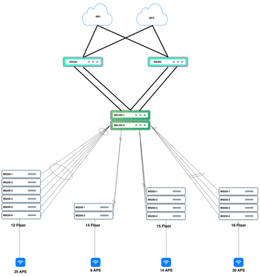

Hi Team,
 I am designing a network with
2 x MX450(Warmspare)
2 x MS425 (Stack)
some MS250 and APs
The question is where I should run DHCP, I have three options
1. Create all VLAN interfaces in MX and run DHCP on MX and leave MS425 as the L2 switch.
2. Enable L3 and create VLAN interface in MS425 and run DHCP in MS425.
3. Enable L3 and create VLAN interfaces in MS425 but relay DHCP to MX.
 Any idea which option is the best and why?
