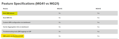

Hi guys,
I was just reviewing the MG41 and noticed the following line item on the product page:
  • Supports up to 5 simultaneous carrier aggregation (5CA)
Does this mean that that I can 'combine' signals from say Verizon and AT&T and double my throughput? Or that I can combine only the same providers signals into one?
Like if I have (5) Verizon SIM cards, and each one only get 10Mbps, then I would have 50Mbps total etc.
Or am I reading/understanding this wrong?
Thanks!

It has slots for two SIM cards ... so I'm not sure how it could combine 5.  I've never used two SIMs at the same time, but I had the impression it used SIM1 unless it fails and then it uses SIM2.

I think at the pvt they told only 1 is active used.  Also read this:
https://forum.peplink.com/t/carrier-aggregation-ca-vs-bonding/31685

No - @PhilipDAth describes the capabilities accurately;  connectivity via one SIM or the other, not both.   I believe 5CA is more like the cellular version of using multiple 20 MHz-wide channels in WiFI (40 MHZ, 80 MHz etc.) to achieve higher throughput.   https://www.4gmobiletech.com/carrier-aggregation
