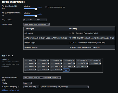

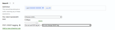

Jeroenvdd
I've set this now as test:
RaphaelL
You can configure a port range.
Jeroenvdd
yeah wierd if i tipe a range it translates it to host 50040-500059 if is type port 50040-50059 it translates this to host port 50040-50059
but I've entered them one by one, shouldn't make a difference

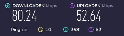

Jeroenvdd
I've turned it of at every level in previous attempts to figure out what's going on, to no avail.
I've now done a 'pressure test' with multiple people doing speedtests to differing sources.
the speed is lowered, which doesn't bother me the only thing i do find really high is that download latency.
Then again it's content shared 'from this site' to others that is the problem so upload latency which isn't great but not to the extent..
