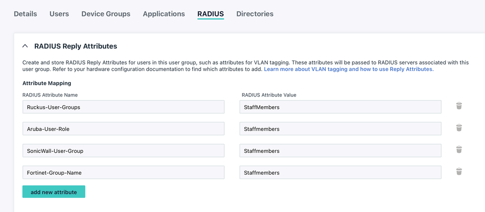

@ngaibut  As mentioned you do that using Radius, below is a screenshot from Jumpcloud showing where you add Radius attributes to groups. The one Meraki seems to use "Aruba-User-Role" as its group attribute option. As long as you create a group policy with the exact same name as what you specify in Jumpcloud it will work.
Screen Shot 2022-05-19 at 10.59.33 AM.pngScreen Shot 2022-05-19 at 10.59.53 AM.png
