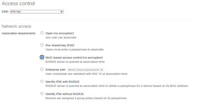

I am trying to convert our system and locations from using our External SSO Radius servers for User/Pass authentication to Certificate based auth so users will have zero interaction while connecting but I need to make it as secure as possible. Has anyone successfully done this using the Meraki APs?
I have the CA and NPS server running and connected to the SSID but to get the clients to connect I have to select
MAC-based access control (no encryption) which means there is no encryption.
How do I keep the connection encrypted and use a certificate that we shoot out via GPO along with the NPS connection profile?

Maybe I wasn't clear enough but we have user/pass already working with our External SSO IDPs. I already have NPS and the CA configured and done and it works in a test network on the SSID I'm using. The problem is the selection of encryption methods with a Certificate based authentication is set to "OPEN" which I do not want.
You need to create a group policy to configure the WiFi settings on the machines.  You can use either EAP-TLS, or PEAP+EAP-TLS.
Then in NPS you need to configure it to accept the same authentication method.
Correct which I have. My issue is related to Meraki though and the configuration of the SSID access. So to get it to work I had to pick the radio button currently selected:
This will not encrypt any connections which is the problem here.
And that is where you select "Enterprise with (dropdown) My Radius server" - Setup your NPS in the radius server fields , setup your rules in NPS to use EAP-TLS , and have your CA issue certificates to your devices (typically done via a GPO and CertTemplate).
We do this a lot of places, with both Meraki and Cisco Classic. Using NPS or Cisco ISE as "your" radius server. It is the most secure you cant get if you remember to setup the client correctly also 🙂
