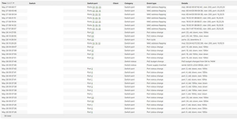

There is nothing in the logs pertaining to the ports where the AP's were connected to it.screenshot.jpg
The switch was powered on, with all the uplinks connected prior. Ports 13 and 15 have AIR-AP3802I-E-K9 and AIR-AP2802I-E-K9 connected and working. Ports 14 and 16 were where the 2 previous AP's that didn't come online were connected.
I did not run a cable test during that time because they were up and working before I performed the cut over. I'll need to get back to you once I can try test this.
