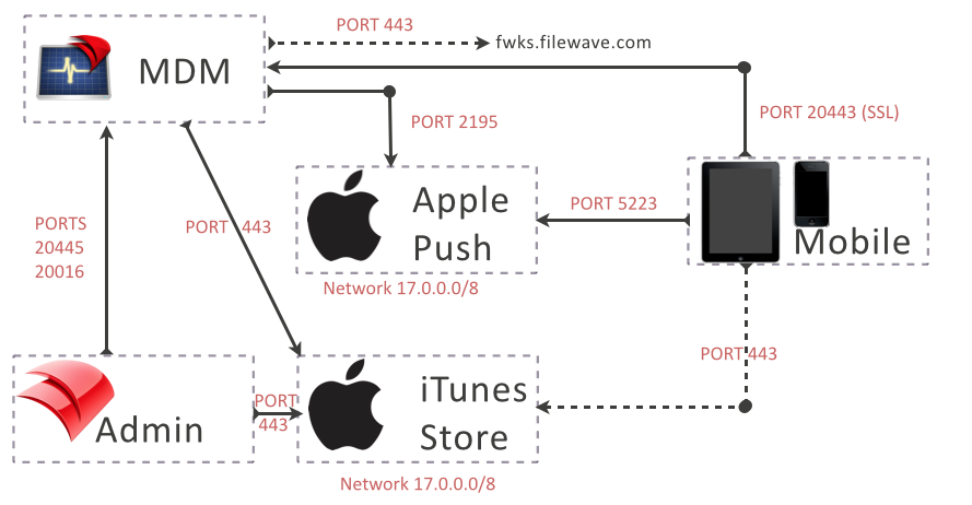

What are the minimum firewall ports for EMM to work on iOS Devices? A diagram would be good.

I appreciate the firewall rules can be found under 'Help > Firewall Info', but this lists a lot of ports that do not look required for the EMM solution.
What would be different in the below for Meraki EMM?

I think your diagram is pretty good.  I think it is 2195 and 2196 (2196 is APN feedback service).

@PhilipDAth Unfortunately it is not my diagram, but its purpose is to show the Meraki document team for something similar.
I know the Admin thing at the bottom left is not required, and the port 20443 between the device and MDM is wrong. I suspect this might not be required at all. But the Systems Manager agent will have a port of its own (I think they are 80,443,5228-5230).
Our customers have asked for a diagram to see how it fits in to their infrastructure, but there is nothing in the documentation.
