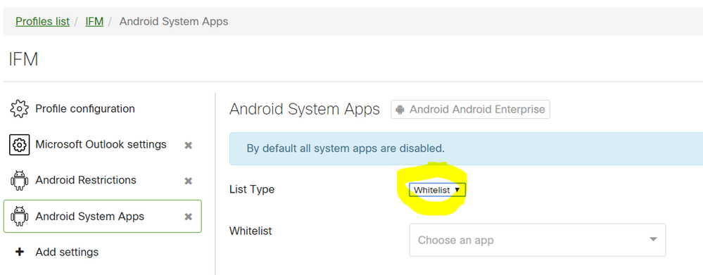

I think what you'll want to do is enabled a whitelist, and then list every application you want enabled. If it is not on the list it will get blocked.
Thanks Philip, but this is only for the Google Apps, what is with Outlook and other Applications that i need?
CRM, Remote app. etc...
This is for every app that ships on your Android phone. Camera, everything.
If you want additional apps like Outlook then just deploy them.

The camera is an app. You just need to get the app ID for it for that phone to enable it again if you are using a whitelist. The apps are quite possibly not in the app store because it was never intended for them to be downloaded.
The "standard" camera app is com.android.camera (so you can try whitelisting that). However that does not mean the manufacturer of any particular phone chose to use the standard app.
Usually you can just good for the IDs.
